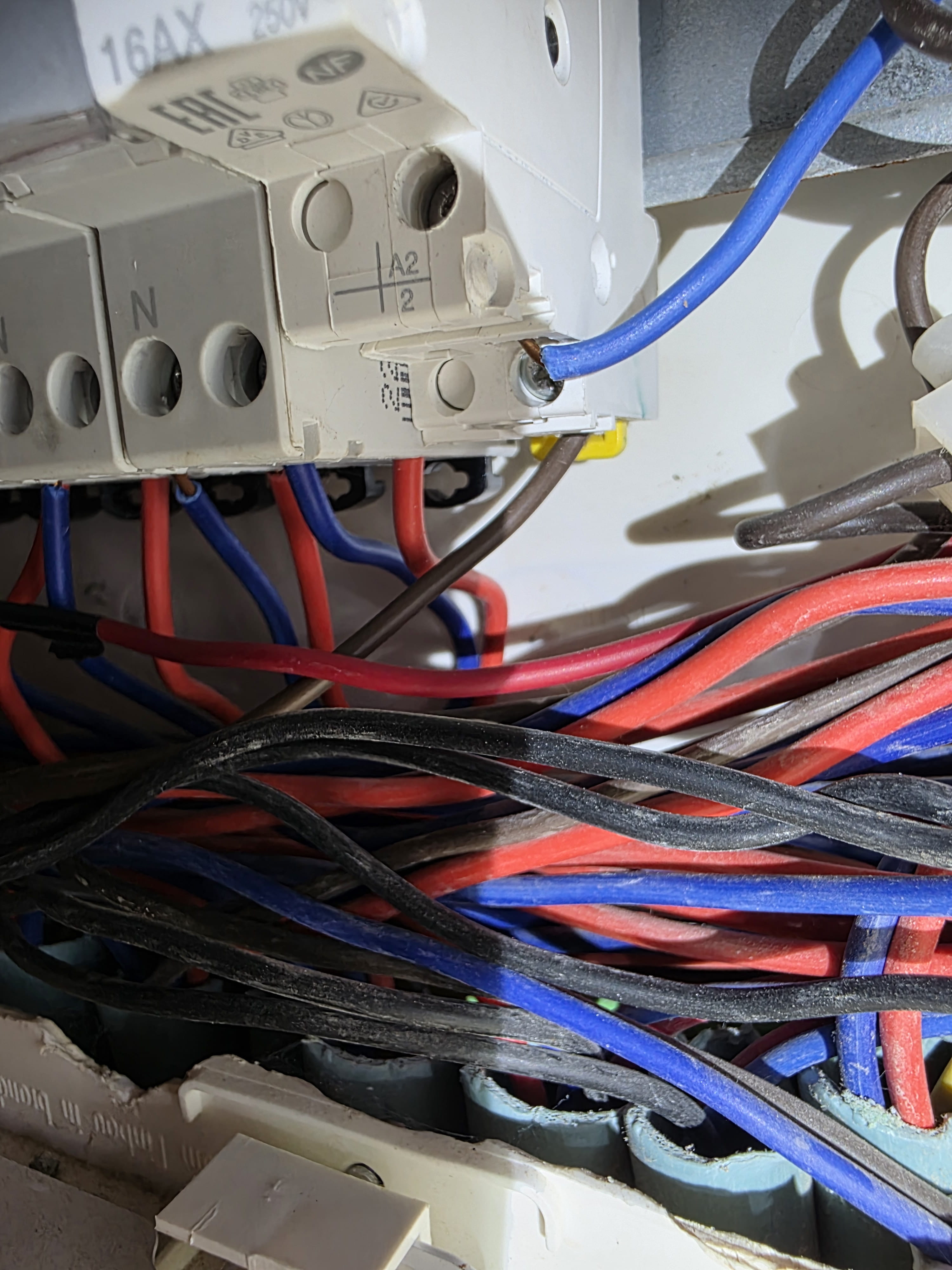

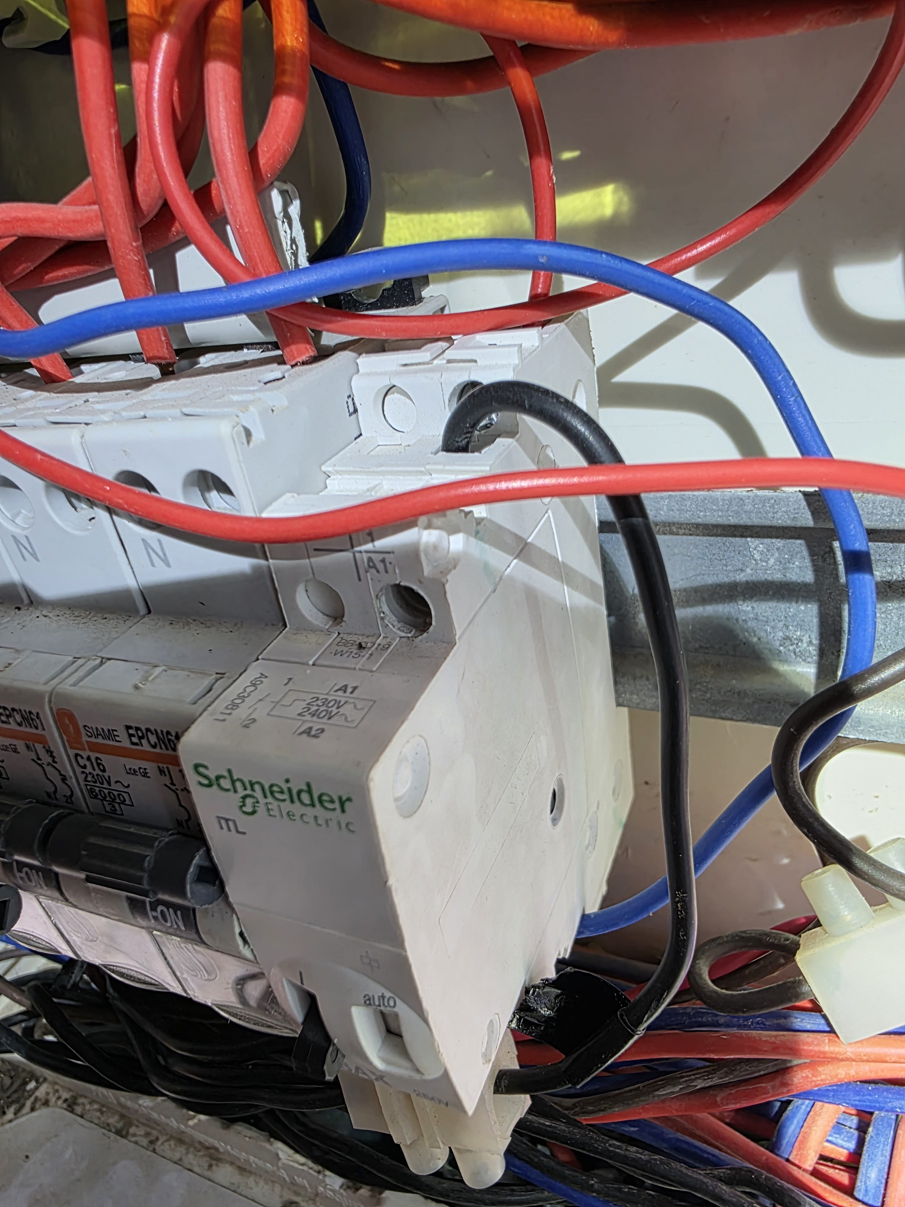

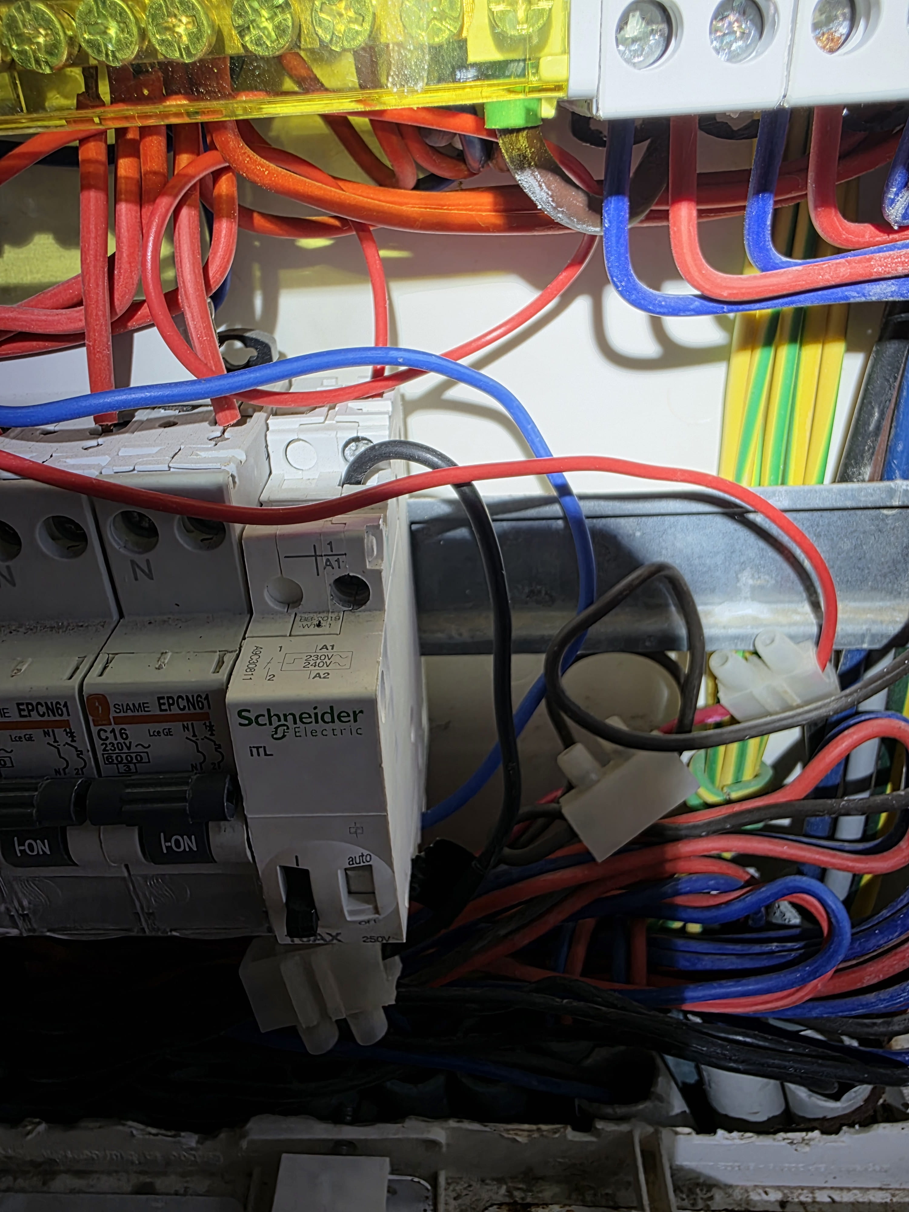

Attached are the two connections
2

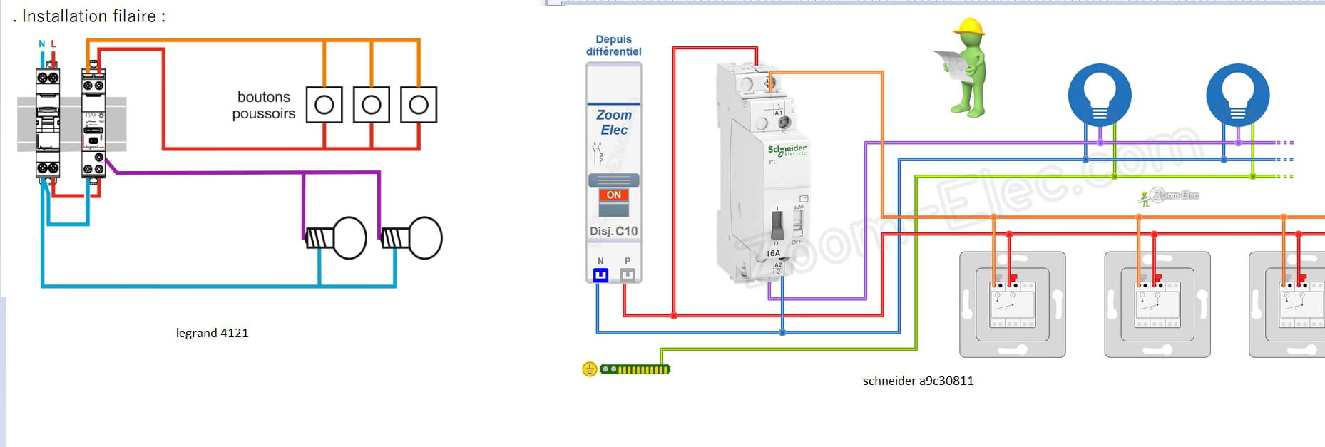

Sauf  pour  schéma que j’ai changé
labricole47 Messages postés 5403 Date d'inscription   Statut Modérateur Dernière intervention   2 853
Can you please,  Write in french
Do the same A1.   A2.       L1..... L2
Traduit avec  mon anglais  à peu près  .....
Il veut changer le  telerupteur et cherche un schéma où une aide

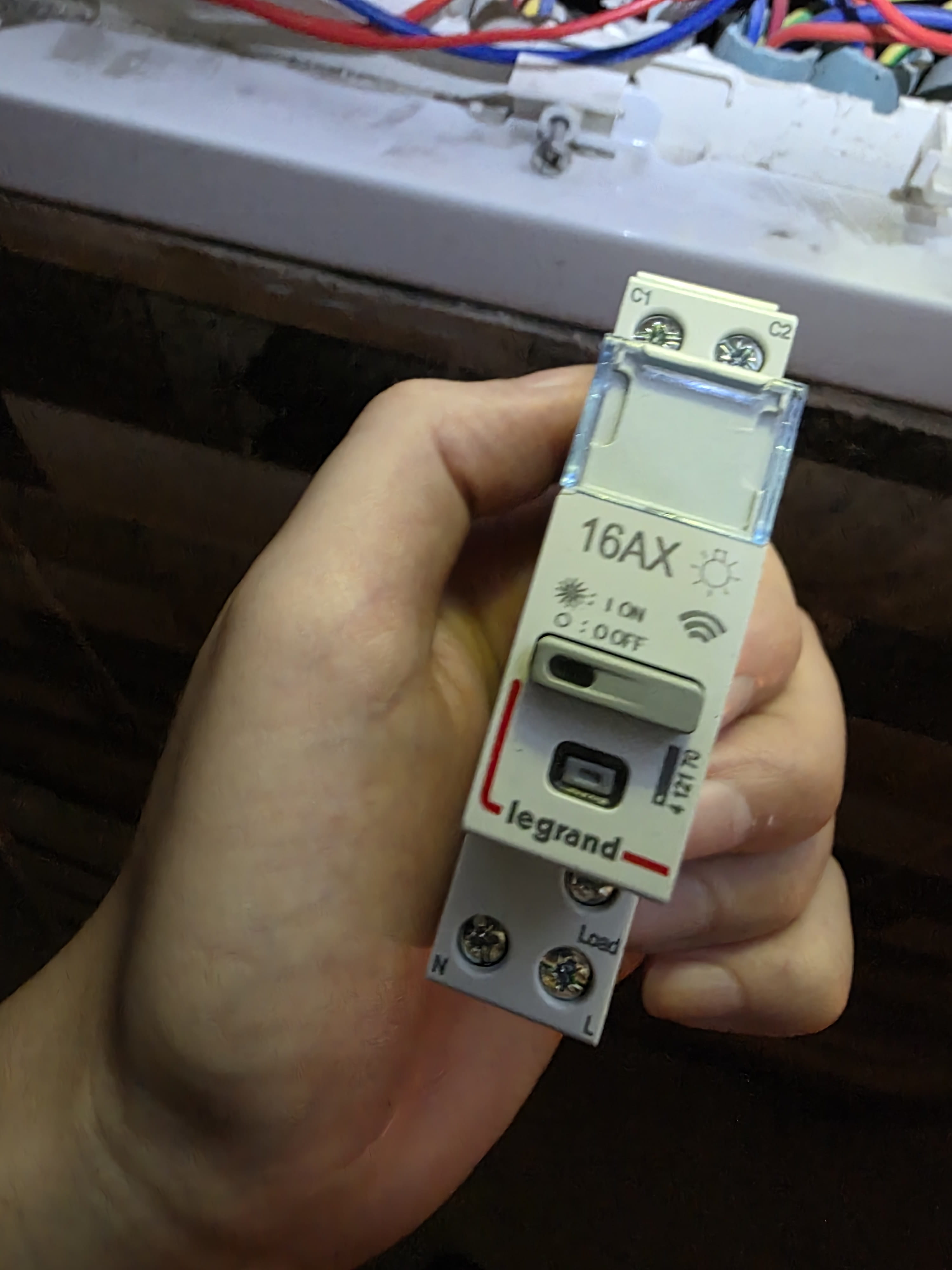

Hello i am sorry i dont speak french the reason why i put it here. because these type switches are used in france only. I am sorry but do you mean by refrence this is the old version schneider a9c30811 and i want to place legrand 412170.

First picture is top and second picture is under. On top there is only black wire then behind it there are 2 holes and on hole has red wire on the right side and front of it there is one hole with black wire. Under area i see a2 with one blue wire front right side en behind it. brown wire right side.
Goofus
Thank you very much i will try this later.
